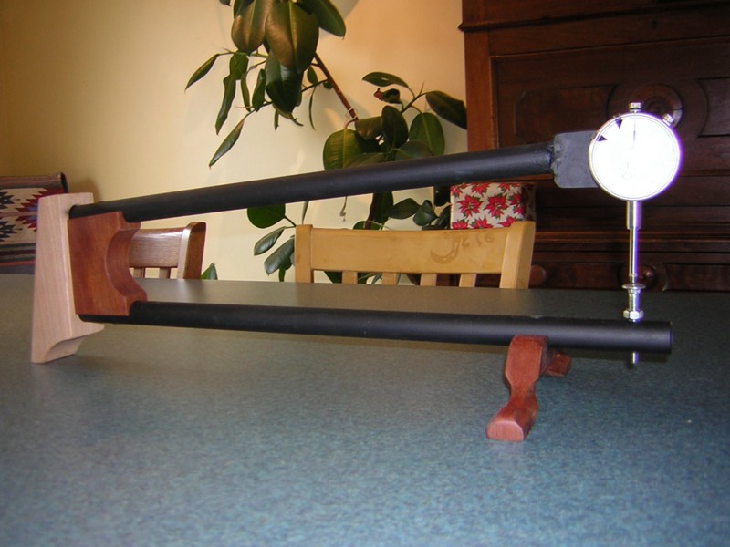

Hi Shane, while you're at thicknesses, would it be possible to show us your thickness caliper that you built, i bought myself a dial caliper from Lee Valley today and thought about yours that was quite nice and wanted to build something similar, it would probably be a good tool for af-one to build himself for a few bucks as well! TIA.
PostPosted: Sat Jan 28, 2006 5:32 pm
Serge, here is Shanes thickness caliper again
And here is a link to the post with several different home built tools etc.

Thanks Rod...I would have had to search through the files for it! Hey! How's the new one? Is every one home and doing well?

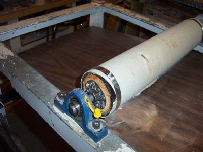

Af One, if you have the means and a small amount of room to sacrifice, I would suggest making yourself a thickness sander (some call it a drum sander). I made two of them so far, and really like the second one, having seen first hand what they are capable of. I was surprised to find how accurate it really is! In a nutshell, it`s a roller 9" in dia. by 22" long with a 3/4" steel shaft through the length with bearings at each end. I made mine from a 2" x 10" 12 ft long that was left over from my construction days. A 1/3 hp motor, with a 1" pulley, and an old fan belt. Now that I look back on it, I think I might have 20 bucks in it total. If you want more info on it, don`t hesitate to ask!
PostPosted: Sun Jan 29, 2006 2:20 am
Cocephus, you have a 9" dia. roller on your sander? That's pretty large compared to most I have seen, people usually make them around 4". What is it made of, and why did you make it that big? How does it work?
(I'm about ready to build mine you see, the joy of hand planing curly bubinga is over...)

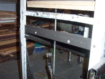

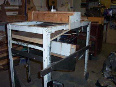

Here`s my version of a thickness sander. Simple but quite effective.
Yes, the roller is 9" in diameter. IMHO, a bigger roller and slower rpm`s would result in better accuracy and less wear on abrasives. Worked for me. As stated earlier, I made the roller from a 2x10x12` pine plank left over from construction days. Lots of 9" circles cut that day. After layout, I drilled the center holes, cut out squares, cut 45`s on each corner to reduce material, and glued them up with grains alternated 90 degrees and opposing, if that makes sense. After a day of drying time, mounted it on bearings countersunk into the ends. Then mounted it to the frame and put the motor on a swing-arm so that tension would be taken care of by gravity. The belt went around the drum, hence no need for a pulley. I applied 36 grit abrasive to a flat pice of counter top material and used that to true up the roller. Stay tuned...

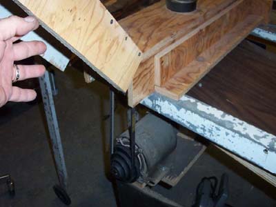

After I got the roller close to true (it shook like the dickens until it balanced out), I cut a pulley groove into the right end of the roller. From there, I went to 80 grit abrasive and finished the trueing. By my calculation, the roller is turning around 600 rpm, give or take. When it was ready, I used 3M spray adhesive to put the cloth abrasive on it. I want to stress using a cloth type abrasive. Holds better and safer. For the pressure to roll on the cloth I cranked up the feed table tight to the roller and rolled it by hand to make sure it had adhered.

One more addition to this post, and I`ll quit being so long winded. This machine is really accurate to within .002". I use it alot for many things other than backs and sides, too.
Now for the safety warnings. Using a larger roller, it`s alot easier to get fingers and other appendages into the roller. I use a flat plate or a push stick, and NEVER get close to the back side of the roller where you might get sucked into it (it`ll take a finger nail off in no time flat).
DUST! This thing is notorious for making dust. I had my dust shield taken off for the pics (and it`s also time to change the cloth). Do whatever you have to do to avoid that dust! Collection system, respirator, etc...

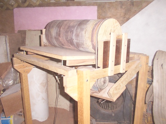

Thanks Rod for the picture, hope it was not too much of a hasle ? Great thickness caliper indeed Shane, i found some nice silver tubing that i'm gonna put to work! i'l post pics when it's done.
Hi Cocephus, i checked your drum sander and it's pretty cool with that 9 " roller! I made my roller out of 3" black ABS plastic tubing which doesn't require trueing, i only cut 2 - 3" dia. plywood discs 3/4" thick to insert at each end of the drum with holes for the shaft. Here's a couple of pics

Serge, your pics look alot like the first one I made. Almost scary! Did you have to reduce your rpm`s at the roller to keep from burning up abrasive, wood, and bearings? That`s the reason I went for a larger roller. It wouln`t have to turn so fast as to burn things up. The slower rpm`s also save on my bearings, too. You might think that I sacrificed power, but it`ll throw things clear accross the shop!
As far as adhesives go, I use 3M 77 spray contact adhesive and cut the edges of my cloth to fit exactly so there won`t be any snags during operation. When it`s time to change it, just tear it off, wipe the roller with laquer thinner and you`re ready to go again.

Yeah i guess you're right Cocephus, i'll either have to increase the drum size or reduce at the roller cuz my drumamajigger turns way too fast and thanks for the tape tip!
